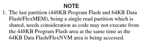

Dears,
As we known, FS32K148 have 4 banks of 512 KB Flash, and the last one bank have 64 KB for DFlash/Flex NVM, if the 64 KB Flash used as Flex NVM, can we use the rest 448KB Flash for code storage? Any confict would happen?
BRs,
Ray
2,039 Views
danielmartynek
Hello dannydeng ,
Yes, it can be used for code storage.
There is this note in the RM rev.11, Section 36.1.2.6.
