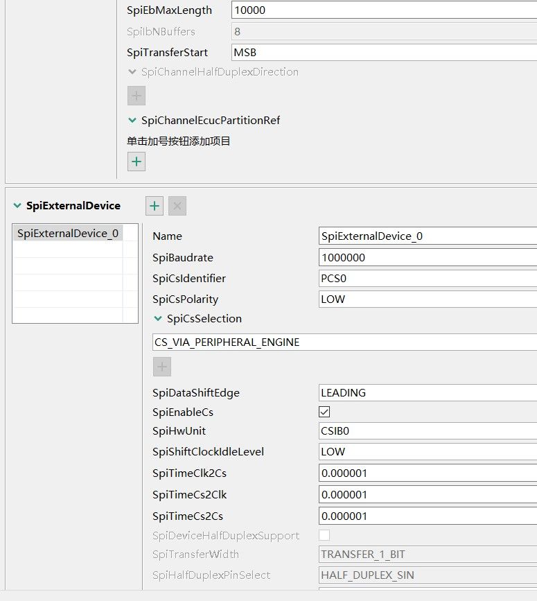

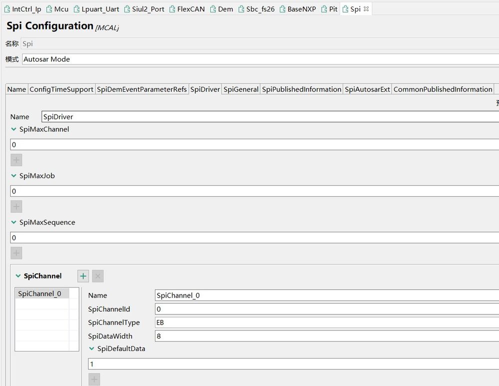

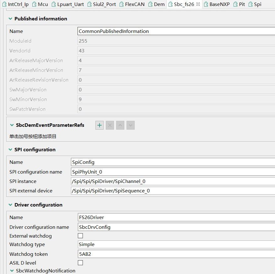

I put my Mcal configuration for SPI and FS26 as the following shown:
