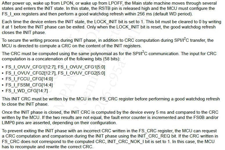

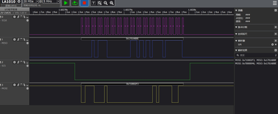

i am building a project with FS2322 and S32K312,but i found a  problem i can not work out, in init mode, when i write data to sbc register, the sdk return ok, but when i read the register, the value is still default value not i writeen before, like below, 0x01ab is default vaule

TomasVaverka
Please try to read the register after closing the INIT state (sending a good WD refresh by 256ms).
BR, Tomas
