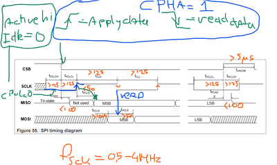

from the timing diagram in the FS23 datasheet I think I can deduce that CPOL = 0 and CPHA = 1, but the nomenclature is varies from place to place("first edge"/"second edge"), so it is tricky to wrap my head around sometimes.
clock source is SIRCDIV2 (8MHz/1)
which results in:
LPSPI0->CFGR1 = 0x00000003 (full duplex, CS active low, input sampled on delayed SCK edge, master mode)
LPSPI0->CCR = 0x01010106 (2 clock cycles of FCLK = 2/8MHz = 250ns SCK<->PSC delay, 3 cycles delay between tranfers, SCK divider = 6+2 =
LPSPI0->TCR = 0x40200001f (CPOL =0 , CPHA = 1, prescale from clock source to FCLK = 1, CS0, MSB first, continuous transfer enabled, 32-bit frame size)
Are these settings correct? If not what are they and how should we have dedudeced them?

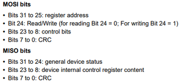

Yes, the FS23 uses SPI Mode 1 (CPOL = 0, CPHA = 1) and one SPI frame is 32 bits wide with the following arrangement:
I think that your SPI settings is correct, but I will let my colleague @danielmartynek who supports S32K MCUs confirm this.

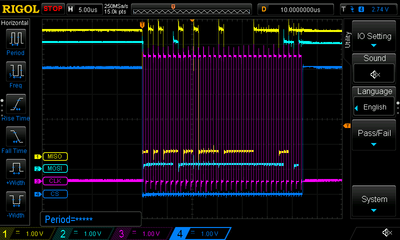

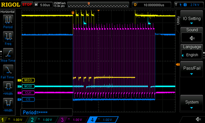

We are now quite sure that the SPI communication at protocol level works as expected. Analyzing with an oscilloscope the signals  we pretty much confirmed that (See attached images).
The issue that still stands up is that the response is not valid. The CRC of the response is not what we are expecting

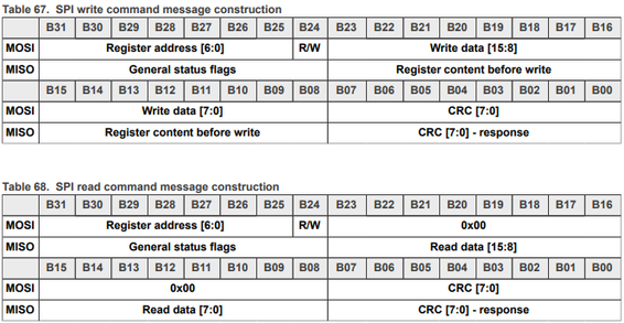

I think that if you want to read e.g. the M_GEN_FLAG register (0x02) using SPI, you need to send: 0x04000008
Explanation:
Register address: 0x02 -> binary: 0000010
Read bit: 0 (since it is a read operation)
Control Bits: 0000000000000000 (16 bits of 0)
So first 3 bytes (24 bits):
Byte 1: 00000100 = 0x04
Byte 2: 00000000 = 0x00
Byte 3: 00000000 = 0x00
CRC calculation using a CRC calculation tool in FS23 GUI:
Hope it helps.
BRs, Tomas

I'm keen to follow the guideline BUT whenever try to read a registry value through SPI in initial sequence the SPI replies not with the value but the exact message I'm sending.
Example message to read FS_SAFETY_OUTPUTS (0x3F)
01111110 00000000 00000000 01001110 = {0x3F<<1 , 0x00, 0x00, crc}
where the 1st value is the address shifter one bit to left and leave bit 24 set to 0 for reading
And the reply I'm getting through SPI (or at least what SPI_PAL high level component returns is exactly the same content).
This is the cause of my confusion. Thank you !
