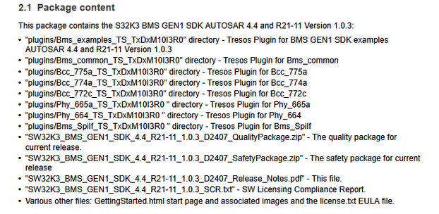

Since I didn't get any feedback from BMS team I am looking into this from available materials.
I can see that 771 is not present in the packages available for S32K358:
However I do not understand the point of FRDM33771BSPIEVB which has demo in Codewarrior, how it is connected to the BCC_77x examples.
I see demo for BCC_S32K144_MC33771_FreeMASTER and BCC_S32K144_Monitoring where the documentation is in XML format included.
Could you be more specific here?
