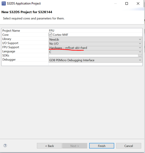

Senlent
Hi@bryan_hong
you can follow below method to enable use FPU
1.For a new project.
2.For an existing project

Dear @Senlent
thanks for your comments.
I know how to set FPU
Btw, I want to know how to check FPU,
If there is an example or method to check FPU, plz guide to me

Senlent
Hi@bryan_hong
you can check the "Disassembly" to see the difference.
by the way, if you already enabled FPU but it still fails, you can check "Optimization Level" is set to None or not, I found that this option has an impact on the FPU settings.
