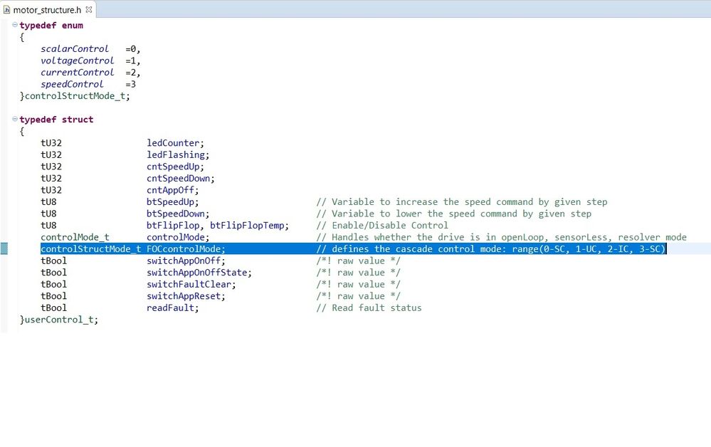

Hello all!
I'm starting out learning about motor controllers and FOC. I have the S32K144 along with the motor development kit : MTRDEVKSPNK144: S32K144
I'm struggling quite alot with finding documentation or descriptions of the different motor control techniques that are available to the FOC control: in the example project downloaded, called MTRDEVKSPNK144_S32DS, the FOC control-modes are in struct "controlStructMode_t" in "motor_structure.h" file. The available modes are Scalar control, voltage control, current control, and speed control. I'd like to know the differences or advantages/disadvantages between them so I can decide on which is best, and why it is better.
I have attached the structs that contain the control modes and how each is implemented in the FOCFastLoop of the main code (current loop of the cascaded control), in case this can help in understanding what is going on. The FOCFastLoop is shown in 2 pictures where "FOC_FastLoop_2" is the immediate continuation of the code from the first picture.
FOC control structures, with available modes.
FOC FastLoop function with scalar and voltage control implementations
FOC FastLoop function with current and speed control implementations
I hope someone can point me in the right direction.

Hi Mark,
MTRDEVKSPNK144 demonstrates primarily advantage of the Field Oriented Control (FOC) technique in Sensorless mode. One of the MTRDEVKSPNK144 feature is that you can select character of the control (or mode). This feature can be used for debug purposes to setup new hardware or to control motor to demanded speed (speed control) or torque (current control).
So it depends on what requires your application either constant torque or constant speed.
Nevertheless, detailed discussion also with block diagrams you can find in application note AN4642 - "Motor Control Application Tuning (MCAT) Tool for 3-Phase PMSM":
https://www.nxp.com/docs/en/application-note/AN4642.pdf
FOC implementation on S32K144 is discussed in application note AN12235 - "3-phase Sensorless PMSM Motor Control Kit with S32K144"
https://www.nxp.com/docs/en/application-note/AN12235.pdf
Marek
