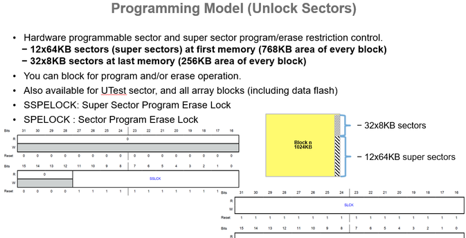

I’m stuck on PFlash/DFlash programming for S32K311 (48-pin). I can now program P-Flash when I place a breakpoint at the end of the write function, but if I don’t keep that breakpoint the CPU jumps to disassembly and RWE flag is set to 1.

DFlash is located in Block_2, locked by SPELOCK[2] and SSPELOCK[2].

2. Unable to unlock last 256 KB of P-Flash:
Anything at or above 0x004B0000 – 0x004FFFFF remains locked even after using all register combinations mentioned above.
Is this region controlled by a different lock block (Block 2?) or shared with D-Flash?
3,409件の閲覧回数

Unlock just the first sector in DFLASH at 0x1000_0000:
IP_PFLASH->PFCBLK_SPELOCK[2] &= ~(1U << 0);

Thank you — D-Flash is now working after using:
However, I still have one remaining issue:
Unable to unlock the last 256 KB of P-Flash (0x004B0000 – 0x004FFFFF)
Everything below 0x004B0000 is working correctly.
But any write/erase attempt in the region:
fails with PES = 1, exactly like a locked block.
I tried clearing all P-Flash lock registers:
PFLASH.PFCBLK_SSPELOCK[0].R &= ~(1U <<0); //PFlash Block0
PFLASH.PFCBLK_SSPELOCK[1].R &= ~(1U <<0); //PFlash Block1
FLASH.SPELOCK.R &= ~(1U <<0);
FLASH.SSPELOCK.R &= ~(1U <<0);
FLASH.XSPELOCK.R &= ~(1U <<0);
FLASH.XSSPELOCK.R &= ~(1U <<0);
PFLASH.PFCBLK_SPELOCK[0].R &= ~(1U <<0);
PFLASH.PFCBLK_SPELOCK[1].R &= ~(1U <<0);
PFLASH.PFCBLK_SPELOCK[2].R &= ~(1U <<0);
PFLASH.PFCBLKU_SPELOCK[0].R &= ~(1U <<0); // UTEST block lock
But this upper P-Flash area remains locked, even though D-Flash unlock and write are now working.
Any clarification on the correct way to unlock and program the upper 256 KB P-Flash region would be very helpful.

I can unlock the supersector at 0x4B0000
IP_PFLASH->PFCBLK_SSPELOCK[1] &= ~(1U << 3);
And reprogram it:
Refer to these tables in the RM:
Table 197. Configuration details when the HSE firmware usage feature flag is disabled
Table 199. Configuration details when the HSE_B firmware usage feature flag is enabled
Table 200. AB swap configuration
