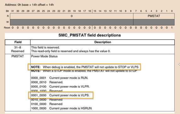

Could you double check power mode status. Possibly different way that using debugger, as it may not reflect it according note below:
2,688件の閲覧回数
GXY
I cannot view the value of this register in VLPS mode, and this bit will not be updated to STOP or VLPS. What I can confirm is that the CPU has not continued to execute the program, and the return value of the POWER_SYS_SetMode() function is SUCCESS after waking up. I think this indicates that the VLPS mode has been successfully entered. As I said before, before entering VLPS, I have configured one pin of FLEXIO to receive the serial port and turned on the interrupt of the SSF flag. After entering the VLPS, I can still wake up the MCU by sending a byte of serial port data. I read the data of the shift buffer in the interrupt exactly as I sent it. The above phenomenon indicates that FLEXIO is still working in the VLPS mode. I think this is inconsistent with OFF in the manual table, so I want to know what the problem is.
