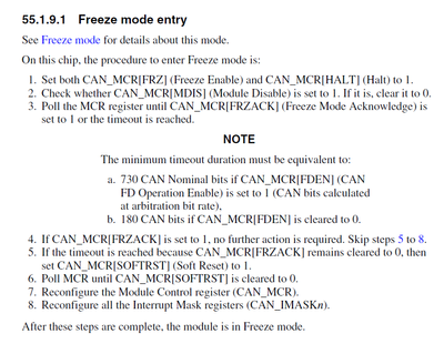

Hello, using the official can bootloader program, which is used to jump the app program to exit can, requires CAN_Seinit. If you keep sending the can command, you will be stuck in the/* Wait for entering the freeze mode */function of CAN_Seinit. Other commands will not have this phenomenon

Hello, I noticed that I am unable to enter freeze mode
NOTRDY and FRZACK bits are both zero
After checking the registers, I still haven't entered low-power mode. Is there any other reason why I can't enter freeze mode? Why don't similar commands have this phenomenon

Hi @zhouqicheng,
Please check 55.1.9.1 Freeze mode entry; it describes the steps needed for entering freeze mode:
