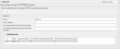

Hi there,
I'm trying to execute simple external GPIO interrupt in S32K3X4EVB-Q172 using push button SW5
I'm followed the https://community.nxp.com/t5/S32-Design-Studio-Knowledge-Base/SIUL2-external-interrupt-example-proje...

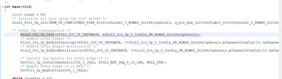

This is main file
But i'm getting an error as "SIUL2_ICU_IP_INSTANCE" not declared and other errors too

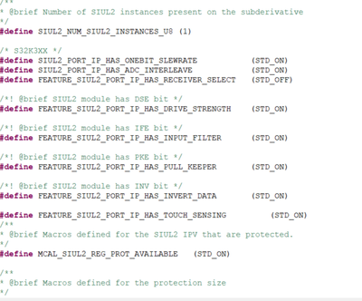

SIUL2 INSTANCE is configured as 0 but its not updated in respected file
Am I missing something in configuration,
Can anyone help this or any example available for GPIO interrupt with push button and led toggle with S32K3X4EVB-Q172 board
The project folder is attached bellow , I'm using RTD 5.0.0.

This HOWTO was implemented using RTD version 2.0.0, and several changes have been introduced in subsequent releases. As a result, some discrepancies may appear when following the instructions with newer versions.
The Siul2_Icu_Ip_Init() function error message is displayed due to a mismatch in the expected configuration parameter. The parameter passed to the function does not exist under the expected name—it was generated with a different identifier.
For example, instead of using: Siul2_Icu_Ip_0_Config_PB_BOARD_InitPeripherals. You should use: Siul2_Icu_Ip_0_Config_PB. This correct configuration can be found in the Siul2_Icu_Ip_SA_PBcfg.h file.
For better reference, I recommend reviewing the Siul2_Icu_Ip_BlinkLed_S32K344 example. It implements the same application as described in the HOWTO. This example is included with the RTD package and can be easily accessed when creating a new project from an example
