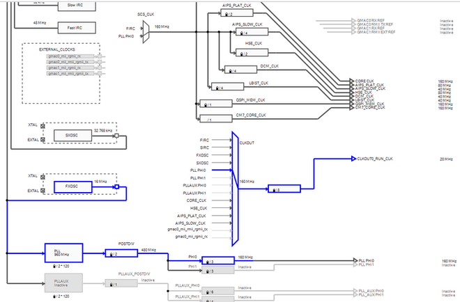

We have configured the CLOCK_RUN frequency to be 20 MHz and it is sourced by PLL PHI0 (which is 160MHz). All the peripheral clocks are enabled in the MCU driver and the MCU is set to RUN mode.
We have configured the GPIO Pin PTD14's GPIO mode as SYSTEM_CLKOUT_RUN_OUT.
The expectation is to see the clock frequency on the GPIO PTD14 to be 20 MHz while measuring through any of the logic analyzer. However, when we measured using Saleae logic analyzer (connected to available GPIO mux pad on the Eval board), the GPIO value is always 0. Noise is observed in the analog channel.
But the clock frequency value read from the API Mcu_GetClockFrequency(CLKOUT_RUN_CLK) is returning the value as expected 20 MHz.

We could identify the connection where the PTD14 is routed and we could measure the configured frequency value from this pin.
