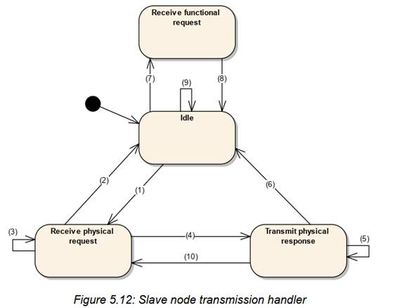

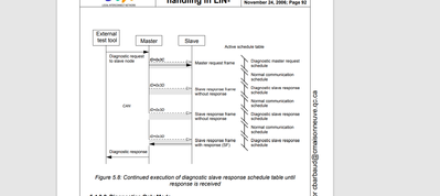

PetrS
see response I got from SW team...
Base on the information which our customer provided, I have some question as below:
  • Diagnostic request ID-3C
For example i need to send
7E 02 10 03 00 00 00 00
[Diep] For my understand, the diagnostic request (3C) is sent with length = 0x02. So, the unused data should be 0xFF instead of 0x00.
  • Diagnostic Response ID-3D
35 02 50 03 00 00 00 00
[Diep] Because diagnostic request is sent with NAD = 0x7E(Functional NAD), the master node should not send diagnostic response header after that. Slave node only receive functional request and do not transmit the response. You can see image below or chapter 5.4, 5.5 of LIN_Specification_Package_2.2A to more detail.
Please help me to confirm with our customer.
BR, Petr
Ans- Yes unused data will be 0XFF.
Question-2
Ans:- Usually in diagnostics we send the Master Req and also we send the diagnostics response header from the master  where slave just update the buffer with the data.
For reference I need some code like this- Solved: S32K SDK LIN Stack not working properly with UDS - NXP Community
Above link is for slave but we need master.
