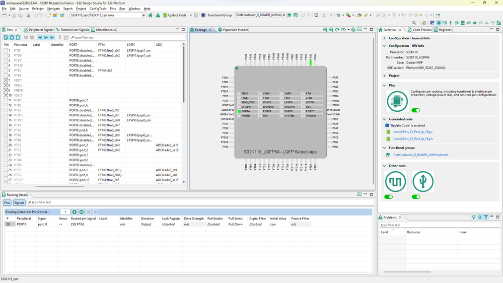

I am new to NXP microcontrollers, and while working with the MCU FS32K118LAT0MLFT, In S32 design studio, I encountered some errors in the pin configuration.
(i) I didn't find the part number in the S32DS
(ii) After , I creating the project in pin configuration, i got errors like files to import

Hi @manibharathi,
Could you please share RTD + S32 Design Studio versions?

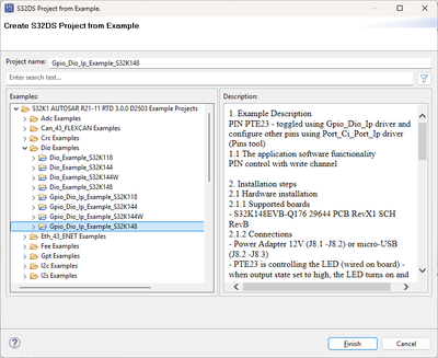

When creating a project, you must: Select a device > Select toolchain (GCC 10.2 for RTD package) > Attach RTD.
After this, you should be able to open the .mex file into S32 Config Tools without issues:
Are you able to import any examples instead of creating a new project?

RTD 3.0.0 is already the latest version for the S32K1 drivers. I assume you already have them installed, if not, please refer to the attached document (Getting Started with the Real Time Drivers (RTD).pdf).
I recommend checking our list of HOWTOs: S32DS - list of HOWTOs.
It shows how to create a new project from example, scratch, how to create a LED blinky example, with and without AUTOSAR layer.
There are also some examples inside the RTD package. Specifically, Dio_Example and Gpio_Dio_Ip_Example projects configure a LED output in the board.
Lastly, you can also refer to the RTD training presentation for Pins and Clocks: S32K3XX Pins and Clocks with RTD. It is based on S32K3XX, however, functionality is very similar.
If you have any issues configuring pinout or with code, please let me know.
