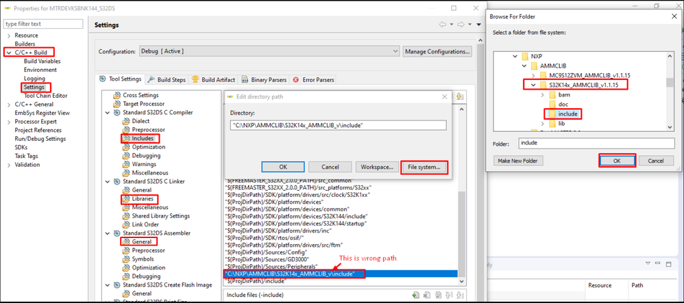

When i try to compile the MTRDEVKSBNK144_S32DS i have as feedback the following errors (refer also to the attached figue)
Please help me to resolve the problem
Thanks in advance for your support
In file included from ../Sources/Peripherals/peripherals_config.h:34:0,
from ../Sources/Peripherals/peripherals_config.c:18:
C:/Users/benderra/workspaceS32DS.ARM.2018.R1/MTRDEVKSBNK144_S32DS/Sources/motor_structure.h:21:20: fatal error: gdflib.h: No such file or directory
#include "gdflib.h"
compilation terminated.

dianabatrlova
I'm very sorry for the delay. I have been out of the office for two weeks.
The main issue is that the S32 Design Studio for ARM 2.2 supports the newest S32 SDK v3.0.2 but the Devkit application was built and tested using older SDK v0.8.6 (which is not supported by S32DS ARM 2.2).
Since this application is not ported yet to the new S32DS you can create a new project on new S32DS ARM 2.2 and use the older one as inspiration or use the older version.

mohamed_benderr
I have uninstall the S32DS_ARM_v2018.R1 and i installed instead the latest version S32 Design Studio for ARM 2.2 – Windows/Linux
when i try to build the same previous example  MTRDEVKSBNK144_S32DS i obtain the following error msg :
nvoking: Standard S32DS C Compiler
arm-none-eabi-gcc "@Generated_Code/Cpu.args" -MMD -MP -MF"Generated_Code/pdb0.d" -MT"Generated_Code/pdb0.o" -o "Generated_Code/pdb0.o" "../Generated_Code/pdb0.c"
Building file: ../Generated_Code/pin_mux.c
Building file: ../Generated_Code/pwrMan1.c
make: *** No rule to make target 'C:/NXP/S32DS_ARM_v2018.R1/S32DS/FreeMASTER_Serial_Communication_Driver_V2_0/src_platforms/S32xx/freemaster_S32xx.c', needed by 'FreeMaster_S32xx/src_platforms/S32xx/freemaster_S32xx.o'. Stop.

dianabatrlova
Hello Mohamed,
Could you, please, check the properties of the project and select the correct path of the AMMCLIB?
Right-click on the project -> Properties -> C/C++ Build -> Settings:
-> Includes
-> Libraries
-> Standard S32DS Assembler -> General
In my case, it looks like this:
I hope it helps.
