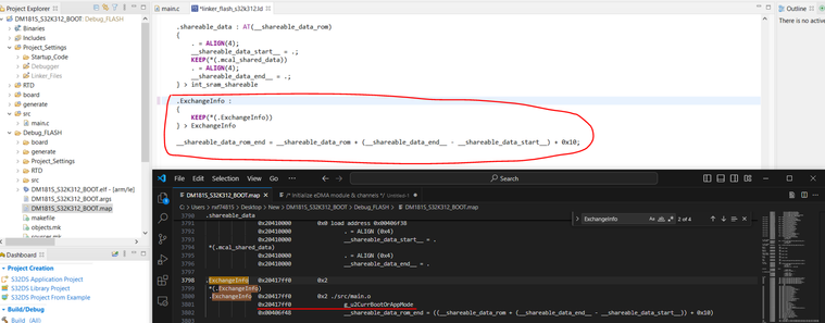

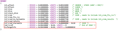

2.Add ExchangeInfo to the linker_flash_s32k312.ld, as attached.

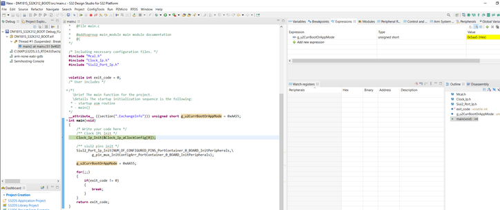

3.The variable g_u2CurrBootOrAppMode is declared in main.c at address 0x20417FF0 (ExchangeInfo), but the compiled map file shows that the variable is located at 0x20408004.
Please respond promptly. Thank you!

I checked your linker file and actually you didn't configure "SECTIONS" areas for "ExchangeInfo"
I made a quick modification for your reference.

1.Based on your response, I modified linker_flash_s32k312.ld, and g_u2CurrBootOrAppMode can correctly point to 0x20407FF0.
2.When I assigned the value g_u2CurrBootOrAppMode = 0xAA55, I found that g_u2CurrBootOrAppMode was not set, and the program crashed, as shown in the image below. For detailed code, see the attachment.
