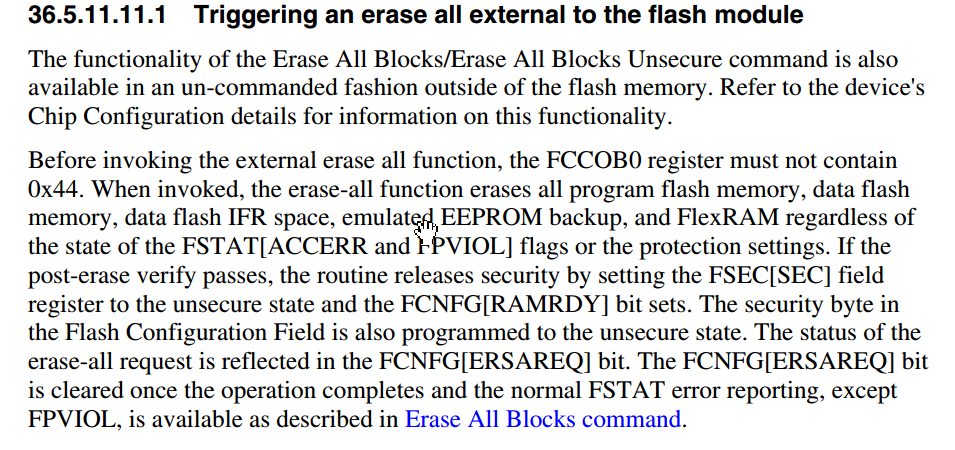

hello,
<1>From reference manual, I can't find the function difference between register ERSAREQ and erase all block unsecure command!
<2>whether can i replace erase all block unsecure command with register ERSAREQ ?
<3>in reference manual  register ERSAREQ  is the sub chapter of erase all block command, I don't know why?
<4>In which scenario will I use this register ERSAREQ ?
thans for your answer!

Hello [email protected],
I think it is answered here:
Erase all blocks
Anyway, ERSAREQ is not directly writable.
