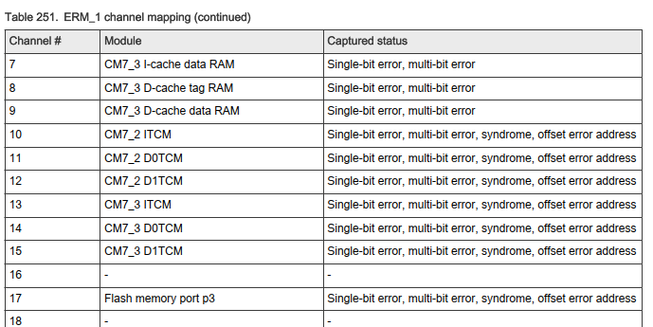

What is the ERM channel number for an ECC error?
2 返答(返信)
1,420件の閲覧回数
MathTeacher
"I corrected the question : What is the ERM channel number for an "Dflash" ECC error?

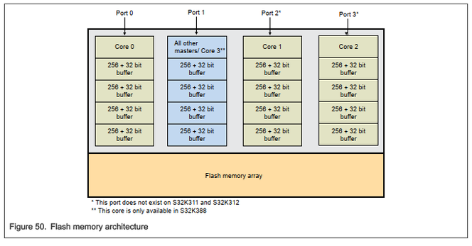

A transfer can go over multiple ports, so it can be catched in one of ERM port assigned to flash.
