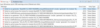

namnguyenviet
Hello @penny_lin,
It looks to me that the license we provided couldn't adapt with EB Tresos AutoCore. Anyway, please try the following license:  638C-602C-EDD8-F498 and see whether it helps.
Nam

penny_lin
Hi Nam:
 I can activate your provided code. But If  I import the can-gw project from the goldvip1.2 SDK.
There are some fail message as the below picture.
If I do  "generate Project". I got the error log about license issue.
Could you help to check it? Thank a lot.
