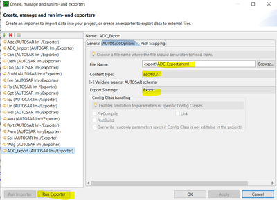

1. Export .xdm to .arxml to merge to another project:
Right click on project that contains .xdm you need to merge to another project -> Im- and exporters
Select Importer/Exporter as Autosar Im-/Exporter
Select Mode as Export only -> Next
Select the Export file name (e.g ADC_Export.arxml). Then select the Content type corresponds to Autosar version of your project.. Select Export Strategy as Export, then Next -> Finish.
After create Exporter, you need to select and Run Exporter to export the existing project into .arxml (This feature will export whole project config to .arxml, not only 1 module). The exported .arxml file will be exported.
2. Import .arxml from 1. to your project:
Right click on project you need to merge -> Im- and exporters
Select Mode as Import only -> Next
Select .arxml which is exported from step 1.
Select correct Autosar version
Select Import Strategy as Merge
Click Next -> Finish
After create Importer, you need to select and Run Importer to import the .arxml to existing project
Maybe there're errors while merging this .arxml because of the conflict between the current project and the import .arxml. You should be aware about this
