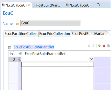

The a drop-down of the routine has a content selection, and my own new project drop-down has no options, how should I set it?

Hi @harryoceana,
The Post-Build Variants are added by the user to the project, you can follow this community post for creating and adding these HW variants: Solved: MCAL Variant Handling in EB Tresos - NXP Community
