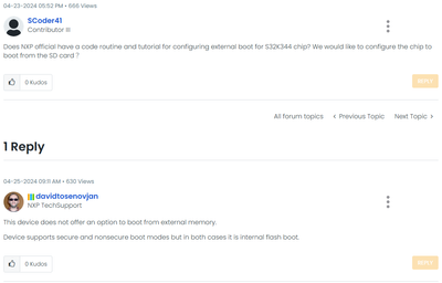

Does NXP official have a manual for configuring external boot for S32K3?

I have confirmed that the S32K344 does not support external boot.
Doesn't all S32K3 series support external boot?
I was wondering if the answer below applies to all S32K3 series?
273件の閲覧回数
VaneB
Hi @Gitae
The hardware platform is consistent across all S32K3 devices; as a result, none of the S32K3 variants support external boot.
For detailed information on available boot options, please refer to Chapter 32: Boot Overview in the S32K3xx Reference Manual, Rev. 10.
BR, VaneB
