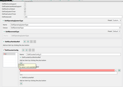

However I am unable to actually add a value instead it gives me a blank drop down menu.

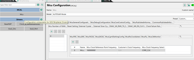

As mentioned in the community post, to add the Osif System Timer Clock Reference,  you need to include the Mcu module in the MCAL. Alternatively, instead of adding a System Timer Clock Reference, you can directly use the Timer Clock Frequency, which is by default of 48MHz on the S32K344 device. Additionally, I suggest to refer to the S32K3xx Reference Manual available at S32K3 Microcontrollers for Automotive General Purpose to check  the default system clock frequency and the available clock sources for each S32K3 device.

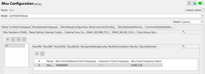

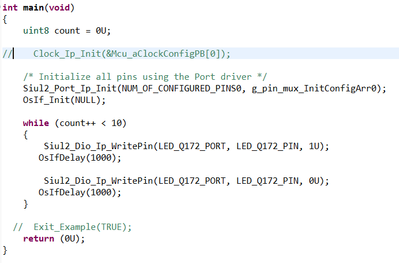

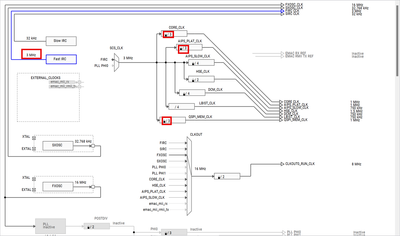

I did add the MCU unit just to test the clock but running the sample code with 1000ms delay it toggles the led every 3 seconds instead of 1. What could be causing this?
7,020件の閲覧回数
pb632146
Contributor V
pb632146_0-1736982082585.pngpb632146_0-1736982082585.pngpb632146_1-1736982094158.pngpb632146_1-1736982094158.pngpb632146_2-1736982110710.pngpb632146_2-1736982110710.pngpb632146_3-1736982118160.pngpb632146_3-1736982118160.pngpb632146_4-1736982124020.pngpb632146_4-1736982124020.png

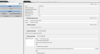

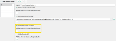

I am realizing that I was supposed to add the instance of "OsIfTimerClockFreq" if I did not want to add the MCU layer, but where do I enable that? I do not see it as an available dropdown. Or is that something not available anymore?
6,944件の閲覧回数
RomanVR
Hi @pb632146
Due to the fact that your MCU is configured with the PLL Clock (160MHz), I recommend adding the following line to your code:
Clock_Ip_Init(&Mcu_aClockConfigPB[0]);
Additionally, ensure you include "Clock_Ip.h" library. this will update the clock reference for all the MCU modules and registers.

To enable the OsIf System Timer Clock Frequency to avoid adding the MCU driver, you can find it under the OsIfSystemTimerClockFreq if in Design Studio 3.5 with RTD 5.0.0

pb632146
Contributor V
I only want to convert ticks to micro/mili/seconds not change the clock frequency so the formula confirmation is appreciated, but wouldn't that formula  convert ticks to seconds not microseconds since MHz is cycles per second.
Basically if I have 160Mhz then : 160 ticks = 1us, 160 * 1000 = 1ms, and 160 * 1000 * 1000 = 1 second correct?
I am on S32DS 3.5 but my rtd only appears to be version 3.0.0? I do not see any way to update to 5.0.0
Also Clock_Ip_Init(&Mcu_aClockConfigPB[0]); previously worked but now does not as it sees mcu_aclockconfigpb as undeclared and I do not know what changed
I have attached my project folder though I do not know how to export my entire  development environment settings to help further.

RomanVR
Hi @pb632146
Apologies for my typo in the formula. You are correct, it will convert ticks to seconds. Therefore, you can just multiply by 1,000,000 or divide the ticks by 160 just as you mention.
To update to RTD 5.0.0, you must first uninstall the RTD 3.0.0 and then download the updatesite of version 5.0.0. Below is a step-by-step guide to assist you:
Uninstalling RTD 3.0.0:
  1. In the "S32DS Extensions and Updates" menu, locate and select every package related to RTD 3.0.0.
  2. Click the uninstall button to remove them.
  3. To confirm the uninstallation, check that the packages no longer appear in the Installation Details menu, located above the Cancel button.
Downloading and Installing RTD 5.0.0:
  1. Go to "Automotive SW - S32K3/S32M27x - Real-Time Drivers for Cortex-M".
  2. Select "S32K3_S32M27x Real-Time Drivers ASR R21-11 Version 5.0.0" and download the zip file named: "SW32K3_S32M27x_RTD_R21-11_5.0.0_D2410_DesignStudio_updatesite".
  3. Open your S32DS Extensions and Updates Menu and click on "Add Update Sites".
  4. Once added, the update site will be available for installation under the list of available packages.
Code Update:
Please replace the following line of code with:
"Clock_Ip_Init(&Mcu_aClockConfigPB_BOARD_InitPeripherals[0]);"
This how the clock configuration structure is defined in your project.
Let me know if this helps and if you have more doubts.
- RomanVR.
Best Regards!
6,803件の閲覧回数
pb632146
Contributor V
The clock works correctly now thank you!
