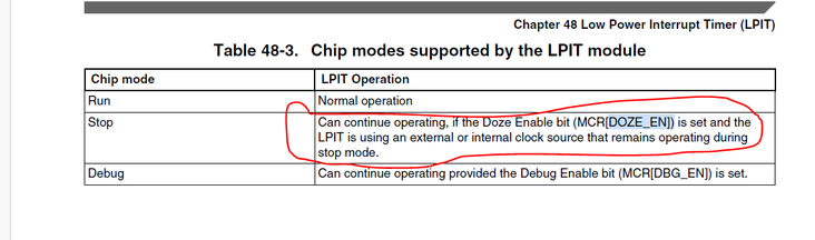

Yes, LPIT can continue to run in VLPS if SIRC clock is selected. Also I found that this bit also needs to be set.
MCR[DOZE_EN]
An interrupt can be triggered by AWIC in VLPS and the MCU can be taken out of VLPS

Many thanks for confirming. I can see that MCR reads as 'D', and that bit is set. I think I may be close to root causing the issue (likely at our end). Could you answer one more thing?
I see that CLOCK_SYS_UpdateConfiguration from NXP SDK says it should only be called in Run mode. I find in our code we use it in a power manager callback registered with VLPS i.e. it gets called when we do POWER_SYS_SetMode(VLPS, POWER_MANAGER_POLICY_AGREEMENT);.
What are the consequences of this?
