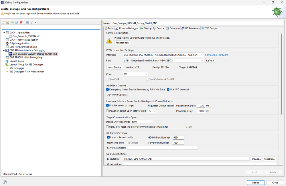

In the meanwhile the onboard debugger seems to run, but it shows an similar behaviour:
Here is the debugger configuration dialog:
It would be great if you could provide a possibility to me to get the hardware up and running again.
Is there some possibility to erase the memory of the microcontroller?
Is there some possibility to restore default settings to the hardware?
