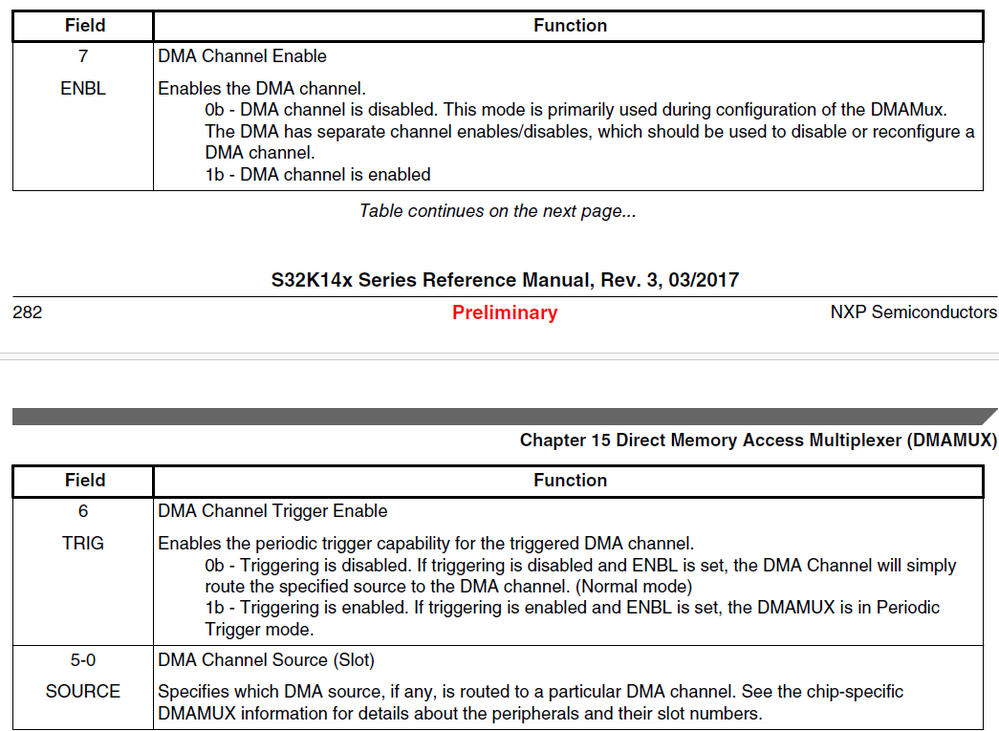

DMAMUX Channel Configuration register SOURCE的顺序在官网哪个手册里面

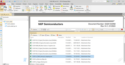

DMA Channel Source的顺序在官网哪个参考文档,由于想用DMA的计数功能,但是找不到DMA SOURCE的顺序,每个IO在DMA SOURCE的顺序里面哪个位置找不到参考资料。官网的S32K-RM.pdf查不到,能否提供下官网哪个文档有相应的说明。

device RM is available from device web page, or direcly using below link
https://www.nxp.com/webapp/Download?colCode=S32K1XXRM
Peripheral's slot numbers is available from S32K1xx DMA Interrupt Mapping.xlsx file attached to the Reference Manual
After opening excel file refer to DMA_CH_MUX sheet
BR, Petr

问题解决了,我下载PDF-XChange Editor,然后打开里面的附件找到了,非常感谢。
