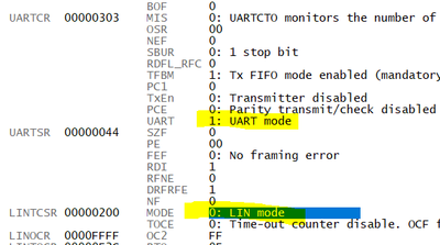

Some of the inconsistencies that we observed is related to LIN register values when Tx is triggered.

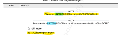

When we select UART mode in UARTCR, as per the reference manual LINTCSR[mode] should always be set to 1 (UART mode). But, as shown in the screenshot below, it is still set in LIN mode, while UARTCR is in UART Mode.
Further, the data registers are both showing not-accessible (????)
Please help with this.
