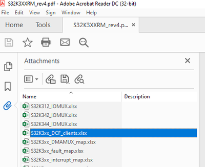

We are trying to disable lockstep mode on the K344 and saw a reference in the S32K3 RM to a dcf_client_utest_misc[LOCSTEP_EN] bit. The RM says to reference the "DCF Clients file attached to this document" for more information.  Where would we find this DCF Clients file for the K344?

Hello, I had the same issue: now I found it in the attachement of pdf.
Anyway, in my case I need to edit the value of UTEST_MISC.
How to modifiy it? The attached excel inside the pdf says "Not memory mapped"

yes, the switch can be done using DCF record – UTEST Miscellaneous Register. You can take a look at file S32K3xx_DCF_clients.xlsx (attached inside the reference manual), tab Utest DCF Client Register Bits. It’s necessary to load new DCF record where the LOCKSTEP_EN bit will be cleared.

Thanks so much. Now I see the attached file. I will take a look at that.
