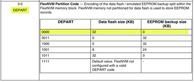

I am currently working on writing data to the D-Flash of the S32K118. However, during the FLASH_DRV_Init process, the D-Flash size is being detected as 0 Bytes, as shown in the code snippet below:
/* Temporary solution for FTFC and S32K144 CSEc part */
/* Get DEPART from Flash Configuration Register 1 */
DEPartitionCode = (uint8_t)((SIM->FCFG1 & SIM_FCFG1_DEPART_MASK) >> SIM_FCFG1_DEPART_SHIFT);
/* Get data flash size */
FLASH_DRV_GetDEPartitionCode(pSSDConfig, DEPartitionCode);
if (pSSDConfig->DFlashSize < FEATURE_FLS_DF_BLOCK_SIZE)
pSSDConfig->EEESize = FEATURE_FLS_FLEX_RAM_SIZE;
else
pSSDConfig->EEESize = 0U;
Due to this, I'm unable to perform read/write operations on the D-Flash. I also attempted to hardcode DEPartitionCode = 0, which results in the D-Flash size being set to 32KB, but when executing FLASH_DRV_CommandSequence(pSSDConfig), the MCU jumps to the DefaultISR.

If the FLASH_DRV_Init returns DFlash size 0, the device has been already partitioned and whole DFlash is used as a backup memory for Emulated EEPROM. To be able to use the DFlash directly, you need to remove the partition and then set new partition which will configure the DFlash as normal flash.
You can take a look at this example in SDK 4.0.1 folder:

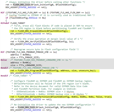

c:\NXP\S32DS.3.5\S32DS\software\S32SDK_S32K1XX_RTM_4.0.1\examples\S32K118\driver_examples\system\flash_partitioning\
This example contains everything you need. To remove the partition (i.e. to erase whole device), you need to build the RAM target.
This will erase the device and partition, reprogram back the flash configuration field and then it will set the partition:

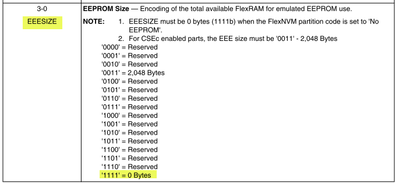

To use whole DFlash as normal flash (so Emulated EEPROM is not used), use following parameters:
ret = FLASH_DRV_DEFlashPartition(&flashSSDConfig, 0x0Fu, 0x00u, 0x0u, false, true);
The rest of the example then shows how to erase and program both PFlash and Dflash.
