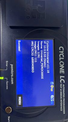

The Cyclone LC offline programming of the executable .hex file with Cesc function was successful, but it cannot run.
Chip: FS32K146HAT0MLLR
The .hex file programming has been confirmed successful. The offline programming of a program without CSEC functionality works fine.
Question: Are there any additional special steps required for offline programming of a program with CSEC functionality? Please provide a detailed explanation. Your prompt response would be greatly appreciated. Thank you!

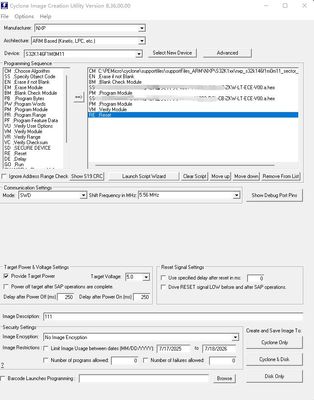

I can't see a difference. How do you enable CSEc? Is the Program Partition command executed by that application?
What does it mean "it cannot run"? Are you able to attach a debugger? What can you see in the debugger?

Our program has already enabled the partitioning command and successfully activated the CSEC function. Our question is:
We use the Cyclone LC software and device to program the .hex file, but the board's program doesn't run. However, after removing the code segment related to the CESC function from the source program, the program can run on the board after programming. So we would like to ask: are there any additional steps required for programming the program with the CESC function?

No specific steps are needed when CSEc is used. I would need to know what does not work exactly. "It does not work" is not sufficient description. What can you see in debugger?
