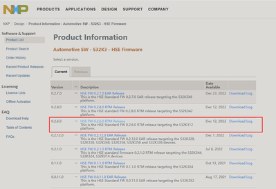

Cppppy
Hi @VaneB
The installation path should be OK, the elf file has been generated and can be downloaded into the S32K12 project board.
I downloaded the HSE FW from the NXP website, the exact address is shown in the picture.

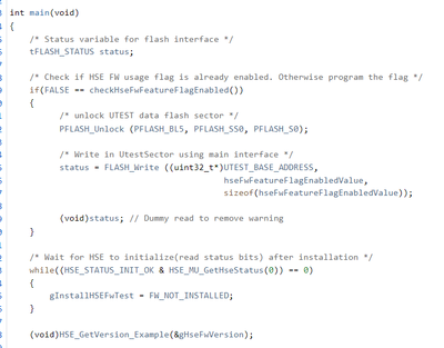

VaneB
Hi @Cppppy
Could you help me with one last check regarding the HSE FW installation?
The HSE Demo App has functions that verify if the HSE was correctly installed. See the below image:
Please help me with the result of this test.

Cppppy
Hi @VaneB
Which installation path can I find the code in this picture? I didn't find this code in C:\NXP\SW32K3_RTD_4.4_2.0.2\eclipse\plugins\Crypto_TS_T40D34M20I2R0\examples and C:\NXP\HSE_FW_S32K3XX_0_2_6_0 path.

VaneB
Hi @Cppppy
These functions are in the HSE Demo App, which you will find where you downloaded the HSE FW.

Cppppy
@VaneB

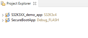

I ran S32KXX_demo_app in HSE_DEMOAPP_S32K3XX_0_2_6_0, but the program went into a loop in the WaitandSetFWEnablefeatureflag function, which seems to indicate that my S32K312 chip HSE FW usage flag is not already enabled.
Is this a hardware problem or is there something wrong with the program's runtime environment?
Another problem is that the HSE_DEMOAPP_S32K3XX_0_2_6_0y I downloaded should correspond to the S32K312, but the DEBUG configuration and program identification in S32DS identifies this program as S32K3X4, so I wonder if this will have any effect on the running of the program?

To change the debug configurations to the S32K3x2, right-click on the project and then select at Build Configurations -> Set Active -> 2 S32K3x2. Please refer below image.

VaneB
Hi @Cppppy
You still have no response from the HSE, so it remains in that loop.
From the image that you shared, I could see that the project was imported incorrectly since if you look at the following image, you can see that you must have the demo app and SecureBootApp.
Please review the steps listed in the HSE_DEMOAPP_S32K3XX_0_2_6_0_ReadMe file that you find in the following path:
C:\nxp\HSE_DEMOAPP_S32K3XX_0_2_6_0\HSE_DEMOAPP_S32K3XX_0_2_6_0_ReadMe.pdf

Cppppy
Hi @VaneB
The problem has been solved and the HSE Demo is now working properly. The reason for the problem is because the S32K312 chip I am using has not been installed with HSE.
Thank you very much for being very patient in answering my questions for so long!
