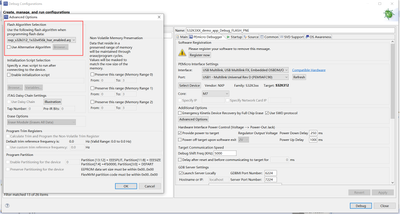

VaneB
Hi @Cppppy
According to your first image posted, the code awaits the HSE's response. So it may not have been installed correctly.
Additionally, did you perform the following step when debugging?
"If the debug configuration is set to Debug_FLASH, go to the PEmicro Debugger Tab => click Advanced Options button => at the Flash Algorithm Selection => select nxp_s32k344_1x32x980k_hse_enabled => click OK button to close Advanced Options dialog."
7,836 次查看
Cppppy
Hi @VaneB
I reinstalled HSE and did what you suggested during DEBUG, but now the problem persists. Is there any other solution please?

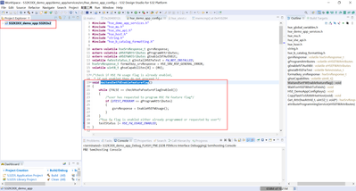

Cppppy
Hi @VaneB
I downloaded the HSE Demo App from the NXP website and tried to open it in S32DS 3.4, but S32DS does not recognize the project. Do I need to do other operations to import the project into S32DS and generate the elf file?
Attached is the HSE Demo App I downloaded, and it doesn't match the code in your picture.
7,743 次查看
VaneB
Hi @Cppppy
The code I share is another version, but the functionality is almost the same.
At the HSE_DEMOAPP_S32K3XX_0_2_6_0_ReadMe.pdf comes the guide on how to Import and Build the project using S32 Design Studio.
7,731 次查看
Cppppy
@VaneB
I ran S32KXX_demo_app in HSE_DEMOAPP_S32K3XX_0_2_6_0, but the program went into a loop in the WaitandSetFWEnablefeatureflag function, which seems to indicate that my S32K312 chip HSE FW usage flag is not already enabled.
Is this a hardware problem or is there something wrong with the program's runtime environment?
Another problem is that the HSE_DEMOAPP_S32K3XX_0_2_6_0y I downloaded should correspond to the S32K312, but the DEBUG configuration and program identification in S32DS identifies this program as S32K3X4, so I wonder if this will have any effect on the running of the program?

7,657 次查看
Cppppy
Hi @VaneB
The problem has been solved and the HSE Demo is now working properly. The reason for the problem is because the S32K312 chip I am using has not been installed with HSE.
