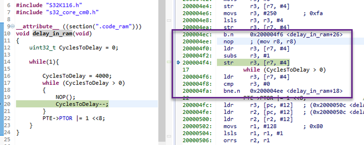

Assembly:
__no_operation();
0002 73F8 NOP
CyclesToDelay--;
0002 73FA LDR R1, [R0]
0002 73FC SUBS R1, R1, #1
0002 73FE STR R1, [R0]
while (CyclesToDelay > 0)
0002 7400 LDR R1, [R0]
0002 7402 CMP R1, #0
0002 7404 BNE 0x000273F8

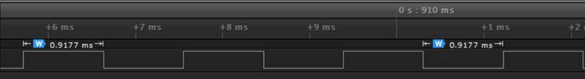

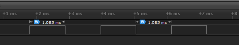

Although the S32K11x series is not that complicated, we can get different results when

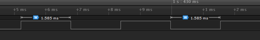

  • the delay code is placed in SRAM:
PTE8 Toggles every 0.9177ms instead of 1ms
  • In Flash with Prefetch buffer enabled: 1.085ms

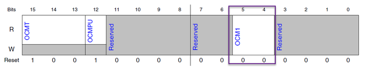

  • In Flash with Prefetch buffer disabled: 1.585ms

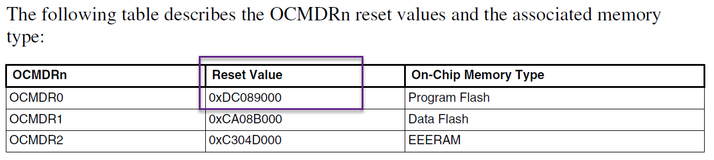

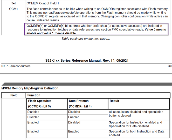

MSCM->OCMDR[0] |= (1<<4) | (1<<5);
Please refer to the RM, Section 35.5.2 Speculative reads for more information about the buffer.

@danielmartynek  Thanks for the reply, It seems that i dont have the Prefetch buffer enabled, Its is possible to determine with exactitude the delay of this routine with a specific MSCM config?
3,653 Views
danielmartynek
Hi @riglesias2021,
The prefetch buffer is enabled by default.

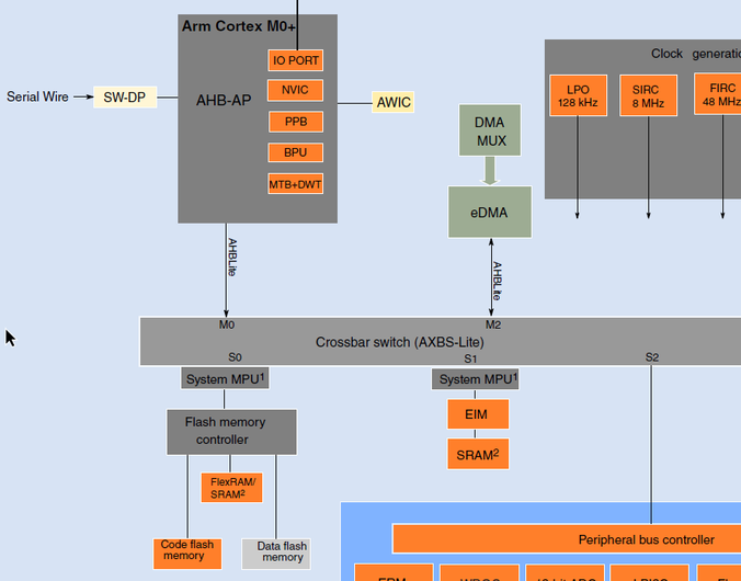

But anyway, I don't think we can determine the accuracy of the timing.
Even with the prefetch buffer disabled, it depends on the location of the code in the flash.
Also, the core accesses the Flash via the Crossbar switch.
The eDMA could add other wait states because of the arbitration on the switch,
I would recommend using HW timers.
