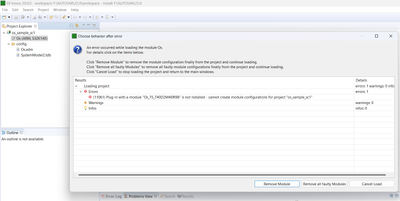

hello i am getting above error while loading the configuration for OS module. I had imported the project from existing Os sample. please let me know if there is solution for this.

Hi @Taresh
I can see you are using SW32K14-OS401-RTM-1.0.0 b4.0.98. In the release notes, the specific supported version for EB Tresos:
EB tresos Studio 21.0.0 b160607-0933
Could you please try to use the correct version?
