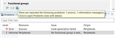

My project is not building because of code generation failure in the peripherals. According to the error message, no function group is selected to be the default initialization function so it will be empty. How do I fix this?

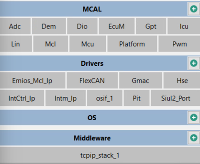

cw20
Hi @VaneB,
I have included all the necessary drivers and MCALs, this is what I have:
Thanks.

cw20
Update: I've fixed the functional group error but there is still an issue with code generation for peripherals

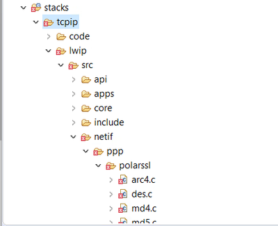

cw20
when I build the project, there is also an issue with the tcpip library that is preventing it from building properly
