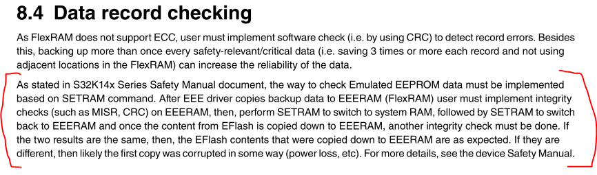

Based on S32K14x safety manual, below explanation is written for checking EEPROM Data .
Implementation hint: The check could be implemented based on the SETRAM
command. This command will copy the active records from the FlexNVM to the
EEEPROM emulation, and the EEPROM emulation can have a CRC check done before
and after command execution to ensure that the correct data was backed up in DFLASH.
On above explnation, eeprom data backup to FlexNVM. and CRC checking is possible.
How can I get example code for above EEPROM Data checking method.
Thank you.

it looks like there's no example for this but it should be relatively simple.
There's a little bit better explanation in application note AN11983:
http://www.nxp.com/assets/documents/data/en/application-notes/AN11983.pdf
In other words:
- write data to EEE (example can be found here: c:\NXP\S32DS_ARM_v1.3\S32DS\S32_SDK_Beta_0.9.0\examples\S32K144\driver_examples\flash\FLASH_Example\GCC\Sources\main.c).
- do a CRC of the data - you can use CRC module for this
- then switch the EEERAM to system RAM using command SETRAM and then use the same command to switch back to EEERAM - this sequence will ensure that all the EEE data are loaded from flash back to RAM, so you can do the CRC again to see if correct data have been loaded from flash to EEERAM.
