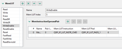

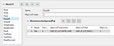

I've configured the Mem LUT Operand in below table of ConfigTools:
Write Enable is 06h and Read Status Register-1 is 05h

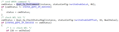

But when I run the example, when run Qspi_Ip_EraseBlock() in main.c
it runs into Qspi_Ip_WriteEnable(),
After /* send WREN command */, when /* check WEL bit */, the WEL is expected to be 1, but it is read as 0. So the program runs into Mem_ExFls_ExampleAssert().

I've missed the READ instruction in the Read Status Register-1 sequence. The problem was solved already.

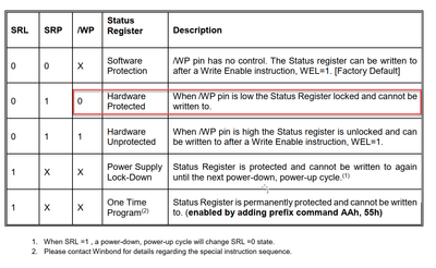

What is your /WP pin connection?
7,929件の閲覧回数
FelixQi
Thank you for your reply!
The /WP(IO2) pin of Flash is connected to PTD12 of S32K344 currently.
7,918件の閲覧回数
davidtosenovjan
If so, do you drive this pin to logic 0?
7,872件の閲覧回数
FelixQi
I don't drive this pin to logic 0 in source code.
I've measured this pin by oscilloscope and it keeps logic 1 during the whole process.
I also tried not connecting this pin, but still meet the same problem.

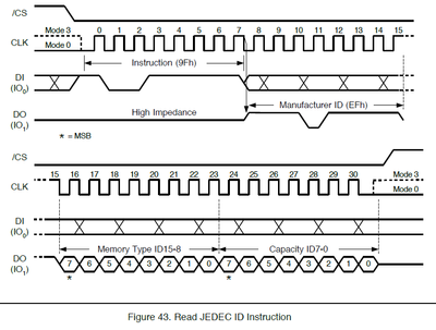

Besides, I've tried another command "Read JEDEC ID". Below is the sequence in the Flash User Manual:
 After I send the read command, I could measure there is data output through DO.
But all data in ReadData keep as 0 after running below  API:
qspiStatus = Qspi_Ip_RunReadCommand(instance, 21, 0U, ReadData, NULL_PTR, 3U);//Read JEDEC ID
21 is the LUT index of ReadDeviceId:
/* 21: ReadDeviceId */
(Qspi_Ip_InstrOpType)((Qspi_Ip_InstrOpType)QSPI_IP_LUT_INSTR_CMD | (Qspi_Ip_InstrOpType)QSPI_IP_LUT_PADS_1 | (Qspi_Ip_InstrOpType)159U),
(Qspi_Ip_InstrOpType)(QSPI_IP_LUT_INSTR_STOP)
It seems that the Flash could response the command but the S32K344 could not read correctly.
I've not sure where the problem exists.
