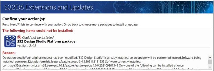

I'm trying to update the S32DS platfrom package along with the RTD and some other extensions for the S32K344. However, I am unable to update due to the following reason attached in the picture. The output text of the error is also presented below:
Operation detailsYour original request has been modified."S32 Design Studio" is already installed, so an update will be performed instead.Software being installed: com.nxp.s32ds.platform.ide.feature.feature.group 3.4.3.202112151555 Software currently installed: com.nxp.s32ds.cle.arm.mbs.arm32.bare.gnu.10.2.feature.feature.group 1.0.0.202109301345 Only one of the following can be installed at once: [com.nxp.s32ds.cle.arm.mbs.arm32.bare.gnu.10.2.feature.feature.jar 1.0.0.202112151550, com.nxp.s32ds.cle.arm.mbs.arm32.bare.gnu.10.2.feature.feature.jar 1.0.0.202109301345] Cannot satisfy dependency: com.nxp.s32ds.cle.arm.mbs.arm32.bare.gnu.10.2.feature.feature.group 1.0.0.202109301345 depends on: org.eclipse.equinox.p2.iu; com.nxp.s32ds.cle.arm.mbs.arm32.bare.gnu.10.2.feature.feature.jar [1.0.0.202109301345,1.0.0.202109301345] Cannot satisfy dependency: com.nxp.s32ds.cle.arm.mbs.arm32.bare.gnu.10.2.feature.feature.group 1.0.0.202112151550 depends on: org.eclipse.equinox.p2.iu; com.nxp.s32ds.cle.arm.mbs.arm32.bare.gnu.10.2.feature.feature.jar [1.0.0.202112151550,1.0.0.202112151550] Cannot satisfy dependency: com.nxp.s32ds.platform.ide.feature.feature.group 3.4.3.202112151555 depends on: org.eclipse.equinox.p2.iu; com.nxp.s32ds.cle.arm.mbs.arm32.bare.gnu.10.2.feature.feature.group [1.0.0.202112151550,1.0.0.202112151550]
Any ideas as to how I can upgrade without having to uninstall and reinstall? it is a very time consuming process and I'd rather not do it.
Thanks in advance!

Hi Mateo,
Have you tried to update offline? You can refer steps 1\2\3 of How to use FreeMaster SDKs in S32K3 RTD 0.9.0. Remember to download the latest  S32 Design Studio for S32 Platform v.3.4 Update 3 with support for S32K3 devices  and  S32K3 Real Time Drivers Version 1.0.0 HotFix 02.
Hope it helps.

Your solution worked!
