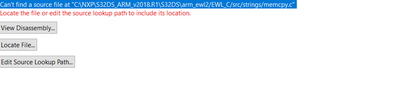

When I tried to execute my code which is for CAN communication  following issue was shown
Can't find a source file at "C:\NXP\S32DS_ARM_v2018.R1\S32DS\arm_ewl2/EWL_C/src/strings/memcpy.c"
I am using S32K144 hardware and S32DS arm 2.2 software.
What might me be the issue?

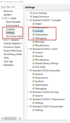

Hi@AparnaSridharan
please check if the file is under this path,if not,please select the correct path for this file.
about how to change the include path.
BR!
