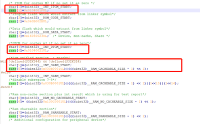

mikesteven
Hi, @lukaszadrapa :
Thank you for your reply and I apologize for the delay in my response.
I checked my startup code and found that the corresponding snippet inside is basically consistent with the one you provided.
mikesteven_0-1688716803637.pngmikesteven_0-1688716803637.pngmikesteven_1-1688716817366.pngmikesteven_1-1688716817366.png
In my LD script file, corresponding intervals have been defined to store data. At the same time, I also placed the corresponding address in the initialization data structure
However, when I put two variables into ITCM during the task, the program cannot run. I used Lauterbach to check the error status register and found that the BFSR ->IMPRECISERR bit was set. Does this mean my code is incorrect?
Mike

mikesteven
Thanks for your reply!
I have listened to your suggestion and checked the initialization of ITCM RAM. I confirm that ITCM has been initialized. Some of the variables I use are declared in functions and may be used for queue operations, so they may not have been initialized when declared. But I placed it in the bss section, and when the MCU starts, the corresponding memory will be initialized to 0.
After debugging, I found that when the first linked data on ITCM is a variable, the program can run normally. However, when this data is an array or pointer (some code will null the address), the program will throw an exception. I think this is because the first address of ITCM is 0. Therefore, I isolated the first 4 bytes of ITCM. And the code that was originally unable to run can run normally.
Moreover, I found that when the 0 address is a variable, the address of this variable cannot be seen in the debugger, and its value cannot be seen either. So I guess this is also due to the 0 address?
Mike

lukaszadrapa
Well, after some testing, I can  see it's caused by optimizations. If optimization level is set to none or to -O1, it is translated in the right way. If other optimization levels are used, it does not work. I can see two quick workarounds:
1. Shift the start of ITCM in linker file a little bit, so zero address is not used.
2. Set optimization level to none or to -O1.
The first workaround is better solution, I think.
Lukas

cg11
Hi, I Set optimization level to -O2. I want to Shift the start of ITCM in linker file a little bit, then zero address is not used, but how to solve this issue "Break at address "0x0" with no debug information available, or outside of program code."
6,835件の閲覧回数
Chris-Sun
Hi @cg11
Why are both parameters ORIGIN configured as 0x00002000 for int_itcm0 and int_itcm ?
