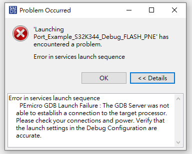

I have a problem about the PEmicro in Step 4.3 Upload Software and Debug.
Getting Started with the S32K3X4EVB-T172 Evaluation Board for Automotive General Purpose
Error in services launch sequence
PEmicro GDB Launch Failure : The GDB Server was not able to establish a connection to the target processor. Please check your connections and power. Verify that the launch settings in the Debug Configuration are accurate.

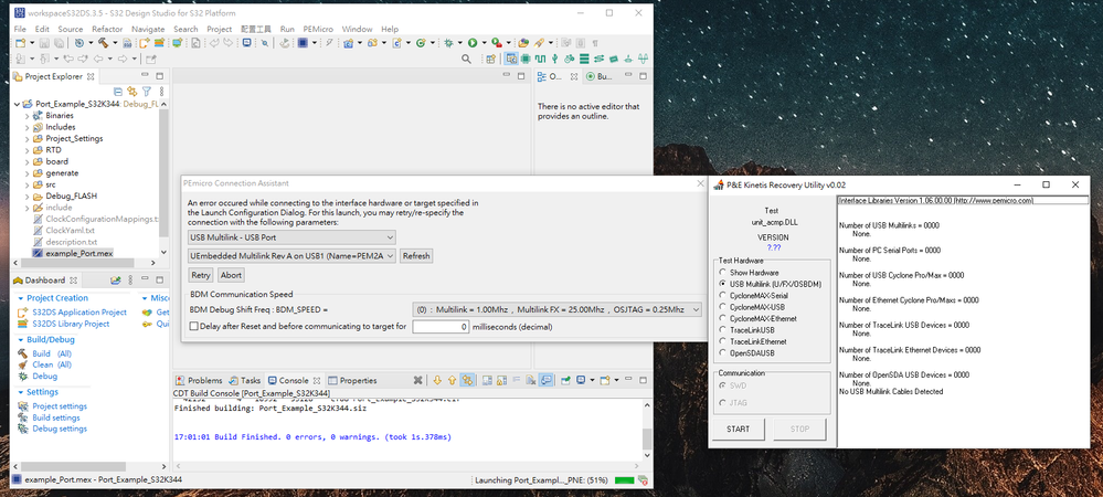

This Can't use PEmicro debugger with S32K118EVB2-Q048 showed Kinetis_Recovery_Utility.zip how  to make sure that the PEmoicro is work, but the figure of my computer shows that PEmicro is still not work.

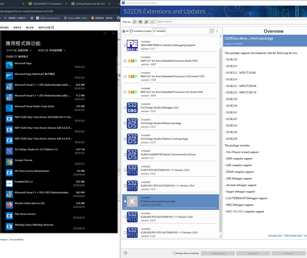

This blew figure shows my installed softwares and drivers.

After Plugging in the Power Supply with a transfer with supported 12 V, the User LED is blinking.
Remember that the EVM must support it with a external voltage.
