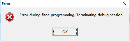

   How could I solve this issue? It occurs when i program on the S32K144-EVB.

   According to your reply, I uncheck "Set breakpoint at" in the "Runtime options" subsection. But S32DS still indicates an error.

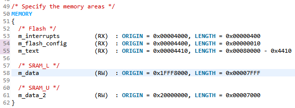

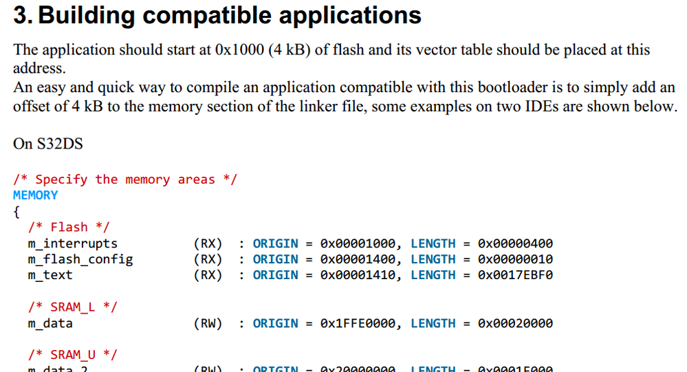

Before S32DS reported the issue "Can not access memory...", I modified the memory section of the application's linker file according to AN12218, S32K1xx Bootloader. pastedImage_5.png
Applicaton's memory section is shown below.
The application, downloaded by bootloader using UART, didn't work. So, I recovered the memory section, downloaded again by OpenSDA, and then, the issue "Can not access memory..." occured.
