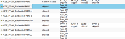

my device is S32K146x,  Is there a register to indicate whether EEPROM partitions allocate CSE key size space?

Unfortunately, the Crypto KEYs location is unaddressable. There is no register available, if you want to know the location of the CSE_PRAM I suggest you open S32K1xx_Memory_Map that is attached to the device Reference Manual.

    The CSE_PRAM register is not directly accessible, so I use the debugger observation is not accessible, right?
