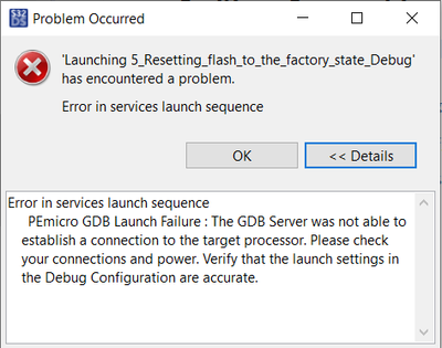

When I say the device is 'bricked', it does not mean that it does no longer function, only that we cannot communicate with it over CAN and we can no longer attach a debugger to the device. The devices do however boot, run the bootloader and end up in the application code. The LEDs show us that the device is running code and is not in an odd state, although CAN communication does not work.
The error that is given by the debugger is that the GDB server cannot establish a connection to the target processor (see screenshot). The first time the board is secured and program it asked "Device is secure. Erase to unsecure?". I have 'Emergency Kinetis Device Recovery by Full Chip Erase' enabled in my debug configuration. When I disable the full chip erase option the question "Device is secure. Erase to unsecure?"  pops back up when trying to debug. Clicking yes again gives the error in the screenshot

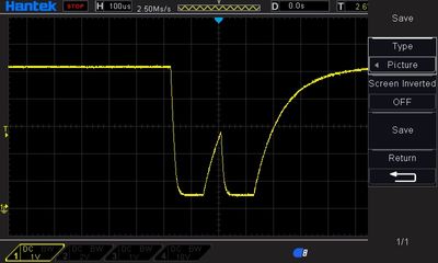

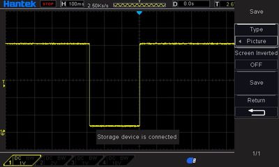

The reset pin is in all cases, secured and unsecured 5V just as the supply voltage of the Chip. When trying to program the device the reset line get asserted (pulled low). See the oscilloscope picture below. During normal operation the line stays a steady 5V.
The reset line when trying to program a secured device (emergency device recovery enabled)
The reset line when programming an unsecured device (for comparison):
