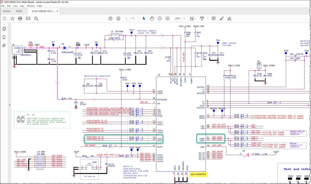

Does S32K148EVB controller require a CAN transceiver for CAN message interaction? or it is inbuilt?

Hi Lohith,
External CAN transceiver is required. You can see the UJA1132HW is used on S32K148EVB.
