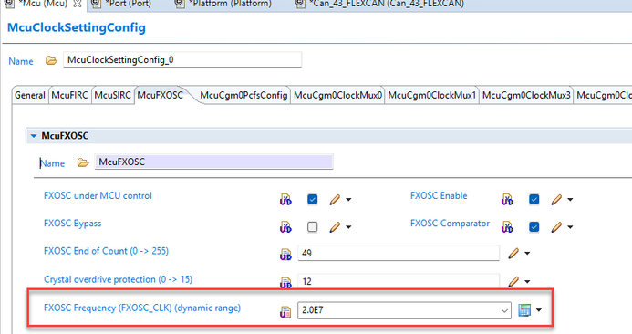

Hi NXP Community,
I redirected the CanIf_RxIndication function. When setting the CAN module to the loopback mode, the test was successful and the transmitted and received data were consistent.
However, when I exited the loopback mode, I was unable to send the message and the Can_43_FLEXCAN_Write function returned 0x02 (busy).
The tx pin of the MCU was synchronized with the rx pin data and was not the expected data to be sent. The rx data was approximately 130ns slower than the tx data and was continuously occurring (it should send one frame roughly every second).
The transceiver is TJA1043. I have set the STB and EN pins to high. CANH and CANL have remained unchanged.
The following is the information of the ESR register. Please help to troubleshoot what the possible cause might be.
Thank you very much!

In the project you provided, your clock configuration is completely wrong.
Your FXOSC clock is 20MHz
The MFI your setting is 120,ODIV2 is 4, which is out of range of PLL VCO output  frequency(240)
 You must follow the requirement in the reference manual:
for your reference:
Finally, don't forget to reconfigure FlexCan's baudrate settings.

Johnson97
Thank you very much. The problem has been solved.
Apart from the aforementioned issues, the configuration of the CAN baud rate-related registers also does not match the valid values specified in the manual.
The waveform of the tx pin of the MCU has met the expectations. The subsequent issues should be related to the transceiver.
Thank you again!
