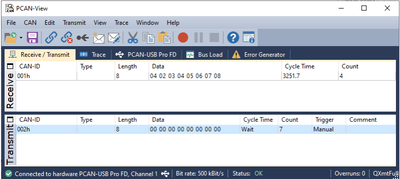

CAN demo examples are running in loopback mode, so to run in Normal mode with CAN tool connection you need to
- add/configure pins connected to CAN transceiver
- check if CAN bitrate is properly set and select Normal mode in FlexCAN configuration
- be sure CAN transceiver is active and properly terminated.
Could below example be helpful?
https://community.nxp.com/t5/S32K-Knowledge-Base/Example-S32K344-FlexCAN-Ip-TX-RX-EnhanceRXFIFO-test...
But it is using low level FlexCAN IP driver.
Attached is modified HLD example. It sends message with std ID 0x1 first then wait for message with std ID 0x2, once received it send ID 0x1 message back with incrementing first byte in payload.
This what I see with PCAN connected on S32K3x4EVB-Q172 board (rev.A).
BR, Petr
