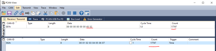

Senlent
Hi@AbhiMR
In the attachment, I have made sample codes for both non-blocking and blocking sending methods.
You can test these two sample projects. If you have any questions or problems, you can point them out and I will help you reproduce and analyze it
This is my test, you can send frame ID = 2 from PC to S32K116, S32K116 will send back the received frame counter and transmited frame counter.
