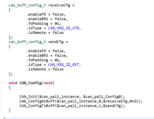

I have a S32K146 an made a project using the SDK and the processor expert. The project has a timer pal and a CAN pal. I initialize the CAN pal in the main function. One message buffer for receive and one for tranceive messages. I tried to send messages with standard and extended IDs. No problem so far.
Now I want to put the CAN init functions into a "system_init" function. In this function the timer, can, gpios etc will be initalisied. The "system_init" function is called in the main routine. If I send a CAN message with extended ID, there is a message only with standard ID. If I send a message with standard ID, the message is a remote frame.
Am I making some mistakes or is initialisiation of CAN, Timer, etc only possible in the main function?

Unfortunately I don't understand the first part of your reply. Before I add my code here, I would like to show you my two options:
Option Nr1 (same option as in can_pal_s32k146)
The CAN Init is done in the main routine. Works without any problems.
Option Nr2
The CAN Init is done in a extern function system_init. The function system_init is called in the main routine. Doesn't work.
Is option Nr 2 a valid option? Or do I have to do the init in the main routine?

I made a simple test project with the problem I have. Every 10ms a CAN message is send. The CAN init is called in the main in two possible ways. If I call all functions directly in the main, everything works as it should. But If I put the CAN init in a function called CAN_Config() and call this in the main, I get a message with a standard ID instead of an extended.
Could you please check if you have the same problem with this project?

  I tested the example code you provided,and I also encountered the same problem as you.
But if I modified the code like this,the problem disappeared.
Still looking for the reason, it may be the reason of the variable.
