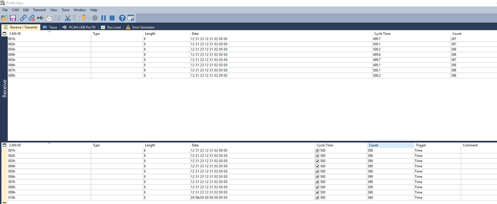

Hello everyone,
I am working on CAN protocol , i want to enable FIFO buffers for my code.
I am bit confused of this.Can anyone tell me what configurations i need to do for this?
I tried but i am getting the below error. Help me to find the solution
Issue: Since CanHardwareObject_TX is used for Legacy FIFO, the CanHwObjectCount configured must be 6 and Can Object Type is RECEIVE

Hi@kavyakoney
I made a demo for your reference, the hardware is S32K148EVB, RTD 3.0.0.

its a demo for polling and used internal mailboxes right.
I want to receive CAN data using the Legacy RX FIFO on S32K148.
The required CAN bus speed is 1 Mbps, and I need to configure the RX FIFO filters, ID tables, and interrupts correctly.
Could you please guide me on how to configure the Legacy RX FIFO and how to read FIFO frames when they arrive?

Hi@kavyakoney
No, the Legacy FIFO is used in this demo, and the baud rate is 500KBPS.
